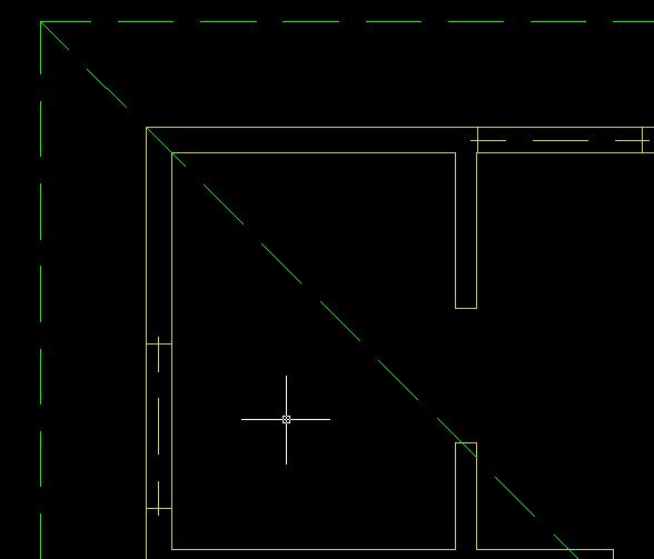

hello,
im pretty new to AutoCAD and i have been teaching myself how to draft as efficiently as possible via Youtube and forums such as this (this one is my favorite). Whoever, today i couldn't find the answer to my question online so i thought i would ask about it on here.
When drawing floor plans, roof plans, floor framing plans, ect. I have to draw in a lot of different size headers above openings. i started out by just drawing them all then going back and extending the line endpoints 1.5-3 inches past the respective openings but that takes too long. So i figured out i could use the LENGTHEN command on DELTA and just go back through and click the end points to extend them the correct amount.
-----What i would like to do is just draw a line and have it automatically extend itself past the beginning and end points i select to a predetermined length. is this possible?
thanks,
Ryan

Direct Link To This Post Posted: 06.Mar.2014 at 00:32
well that was more trouble than it was worth.
any ways here is what i mean
Back to Top
John Connor View Drop Down
Senior Member
Senior Member
Joined: 01.Feb.2011
Location: United States
Using: AutoCAD 2018
Status: Offline
Points: 7175
Direct Link To This Post Posted: 06.Mar.2014 at 00:38
Are you talking about the dashed line that overruns the two small solid lines like where a window or door might be located?  You're having a problem drawing those??
OK...the solution is to make the header a dynamic block with a stretch option.
Edited by John Connor - 06.Mar.2014 at 00:53
<<AutoCAD 2015>>

Direct Link To This Post Posted: 06.Mar.2014 at 01:13
yep, the dashed lines are the "headers" of which i speak.
i wouldn't say im "having trouble" drawing them, i just don't want to waste time drawing each one. Remember, im aiming for efficiency.
that sounds like a great solution. i'll have to look up how to do that.
thanks John
