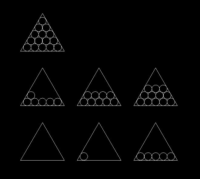

Hi, its my first post here, i use AutoCAD2010.
Below is the link of pic of the drawing i m talking about.
I can create this drawing by.
1. making 1 circle of bottom row 10 radius. 2. copy that to the right 3 times
3. make another circle with ttr of above row 4. copy that to right 2 times
5. repeating same steps 2nd row 6. and top circle .
7. then making boundary line with xline (horizontal) and using line command + tan + bject snap tracking.
8.  Trim and scale the whole figure with reference of given dimension.
I have 2 questions here.
1) Is there any simpler way to make this drawing?
2) How can i build this drawing if i first make the triangle and then circle?

http://s38.photobucket.com/user/sadiq3210/media/triangle_zpsc641fbe7.png.html

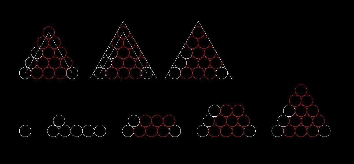

I tried your little exercise and despite doing it differently it still took me eight steps.
However, if the triangle was drawn first then it could be done in seven steps.
Edited by John Connor - 10.Mar.2014 at 14:14

I used the Circle, Array, Copy, Polyline, Offset and Erase commands.

The seven step plan.
