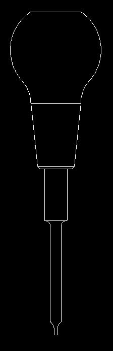

A quick sketch.
<<AutoCAD 2015>>

Direct Link To This Post Posted: 15.Mar.2014 at 12:15
Like I said before start at the tip of the screwdriver and work your way up.  Just rough it out first.  You can go back and take care of the chamfer and a couple of the fillets afterwards.  For the top of the screwdriver use the circle command and don't forget the TTR (tan-tan-radius) option.  No dimension is given for the flat across the top so use whatever you think looks best.

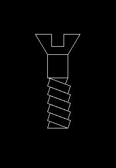

A rough sketch of the screw should take no more than 5 minutes.
Start at the top and work your way down to the point at which the threads start.  JUmp to the very bottom and work your way up.  The basic shape of the thread is a rectangle so use the appropriate command to create one of the correct size, rotate it 20 degrees and array or copy it upwards.
<<AutoCAD 2015>>

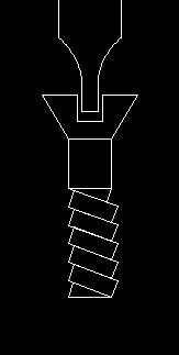

The tip of the screwdriver and the screw.
<<AutoCAD 2015>>

Direct Link To This Post Posted: 15.Mar.2014 at 12:33
PS- That is so very helpful, the screw had been giving me problems regarding using the 2- degrees.
