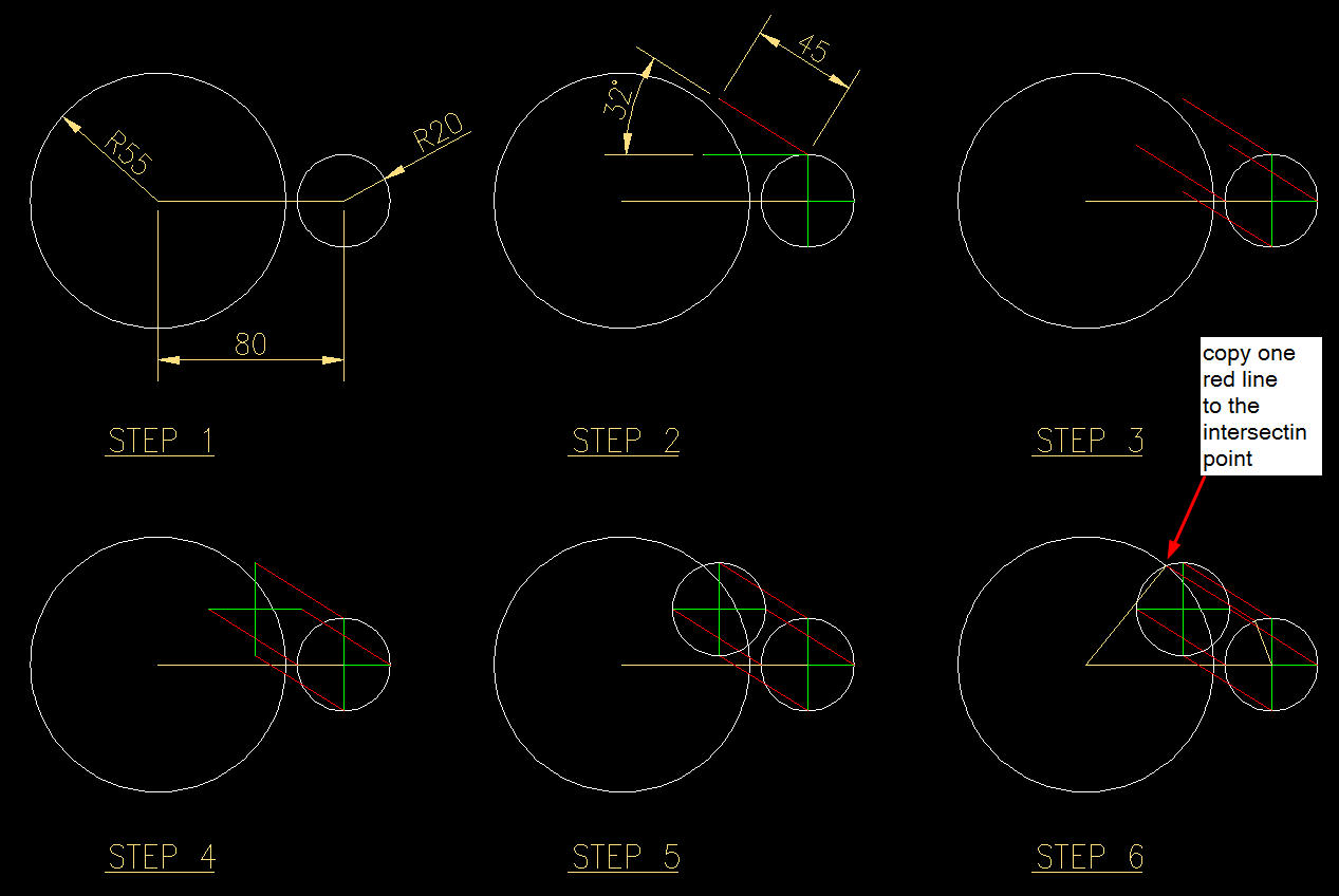

Hi guys,
According to the provided  information. How can I draw the shape ?
Thank you.

Hello wtojp2013, I supose that this is exactly a "parametric constrains" test for you.
I don't know all about this but having tried it, it looks like you have to deal with a formula inside it.
I have done a file with constraints, can we see yours before ?

This certainly doesn't do the whole thing for you, but it might give you something to start from:

Direct Link To This Post Posted: 02.Apr.2014 at 19:00
Hope it's helpful for you.

Direct Link To This Post Posted: 02.Apr.2014 at 20:13
Hello dylhunter, your solution looks so simple that you could even go from step 2 to step 6 directly.

Direct Link To This Post Posted: 02.Apr.2014 at 22:17
Yes. I just want to show the track of the end point. Actually, we can copy the dia. 22 circle to the end point of red line at step 3. then copy one red line to the intersection point. Done.

Direct Link To This Post Posted: 02.Apr.2014 at 22:20
Sorry. Should be the rad. 20 circle. Not dia. 22 circle.

Direct Link To This Post Posted: 03.Apr.2014 at 05:38
dylhunter,
Thank you very much. This technique is very useful for me.

Direct Link To This Post Posted: 03.Apr.2014 at 07:51
dylhunter and wtojp2013, I'd say that wtojp2013 and my method work the same in 2 steps.
wtojp2013 is purely geometry and works 100% without any problem.
It should be prefered to mine but if not applicable to a purely geometrical solution you could test it ( see the file : SHAPE_01_A.dwg in the AutCAD blocks library and tell me about it ).
