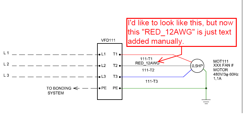

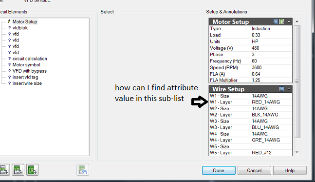

Direct Link To This Post Posted: 21.Apr.2014 at 19:35
I want to access the sub-list table (or something else if is possible) to call out value ("WIRE SIZE")
Please see attached photo for a better understanding of what I want.

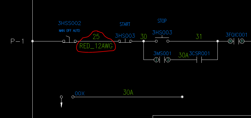

Direct Link To This Post Posted: 21.Apr.2014 at 19:50
I don't know how you would add that unless you edited the wire number block by adding an attribute for size.  The block name is WD_WNH.

Direct Link To This Post Posted: 21.Apr.2014 at 20:03
There you go.  Now when I insert a wire I get to tell ACADE not only what the number is but the size as well.
Just be careful what you wish for because it could come back to haunt you later on.  You might be better off creating a brand new wire number block instead of using the one ACADE provides.  You'll have to determine for yourself if that is a wise move or not.

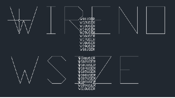

Direct Link To This Post Posted: 21.Apr.2014 at 20:34
I tried to edit the block "WD_WNH" with a new attribute "WSIZE".  Next I inserted a new  marker_blocks "WS01" in my "ace_cb1_***" and I called in spreed sheet "(c:ace_cb_wnum nil 1 nil)
Could you please tell me what I'm doing wrong?  because something is not working.
Would be very much appreciated your help. Thanks in advance.
