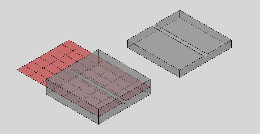

One of many possible options is to slice your block using a surface.
The block on the left includes an extruded line (resulting in a surface) that will be used in the SLICE command.
The block on the right shows the end result.  The SLICE command allows the user to keep BOTH or ONE of the sides of the sliced 3D model.

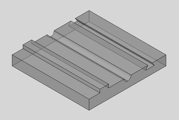

This block has been sliced with a surface that had a bit of an unusual pattern.
