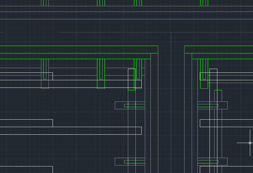

I have a drawing with two layers. Objects of those layers overlap each other.
How can I make elements of green objects invisible inside the white objects? In other words, I want the white objects to be 'above' the green objects, without actually setting them above in 3D.

Use a WIPEOUT?
