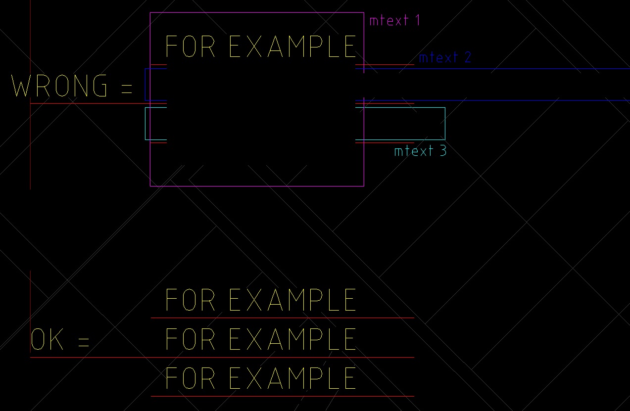

Does anybody knows a macro or a lisp which will first select all the mtext objects in a drawing. Second; create a background mask (background color) for all those selected mtext objects. Third; puts the "defined width" to 0 or just as long as the text?
And finally; send all these mtext object above all other objects with draworder.
The reason why;
I do have a drawing with a lot of mtext objects in different layers. Some do have a background mask and other doesn't have. Some mtext object with a background mask do have a large defined width meanwhile the text is short. Because of that a part of the drawing is not visible (see picture).
If I use the quick select command, I do can select all the mtext objects. After that I can use the draworder command and I can change the background mask settings of all those objects. But I can not change the defined width value. It isn't visible at the properties palette. Do I select only one object it does but all it doesn't...
Example:
(the rectangles are the background masks from the 3 mtext objects)
Does anybody knows a solution for this problem?
