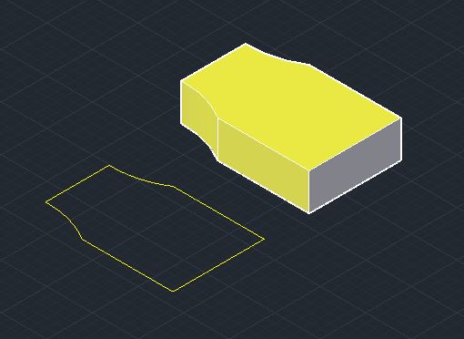

John Connor
Senior Member
Joined: 01.Feb.2011 Location: United States Using: AutoCAD 2018 Status: Offline Points: 7175 |
Posted: 20.Jun.2014 at 11:47 |
Footprint on the left; extruded version on the right. |
<<AutoCAD 2015>> |
