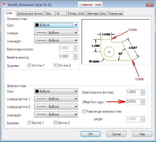

Set to zero offset from origin on the dimensions ( command DDIM ).
