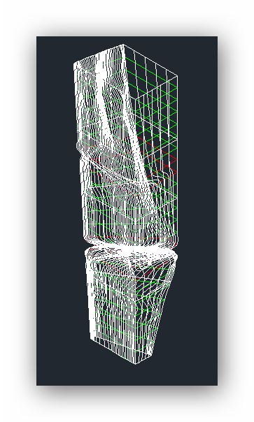

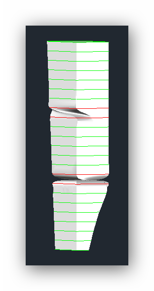

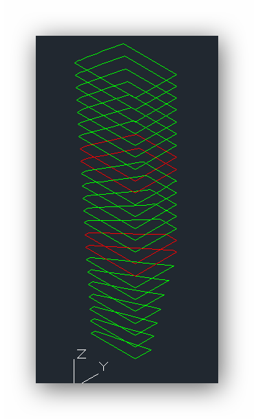

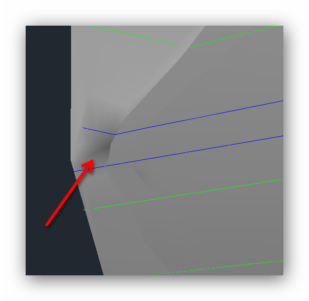

I prepared closed profiles for lofting, but I encountered a problem. Can somebody tell what could be the problem?
Here are some picture illustrating the problem:
Profiles in red denote the place of irregularity in the lofted 3D solid.
Thank you for any help.
Kind regards, Hrvoje

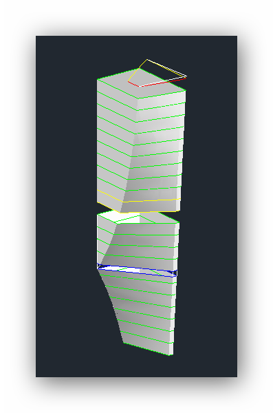

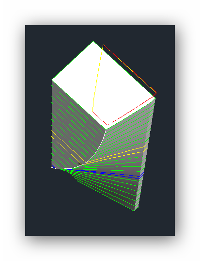

Thank you John for your answer. Here is the file with the drawing:
uploads/497931/VL_za_krmenu_protustatvu_-_2.dwg

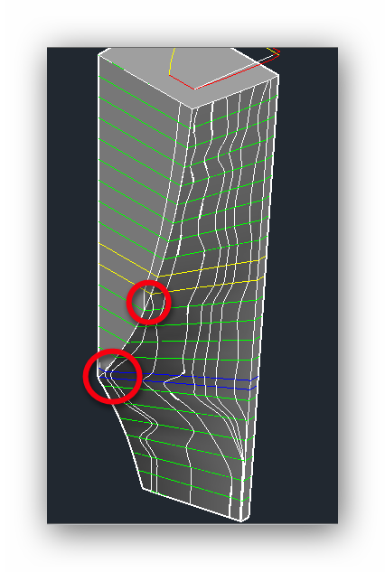

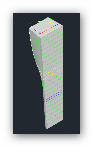

In the meantime I found out that the closed profiles are not of the same type. There are polylines (green), splines (yellow) and 3D polylines (blue).
In the next step I added one profile on the place where the solid has discontinuity in the form. The first blue line, lower. Also, I started to loft from the top (!?) and the form was better.
On two places I have the irregularity in the surface. I don't know yet, how to solve this problem.

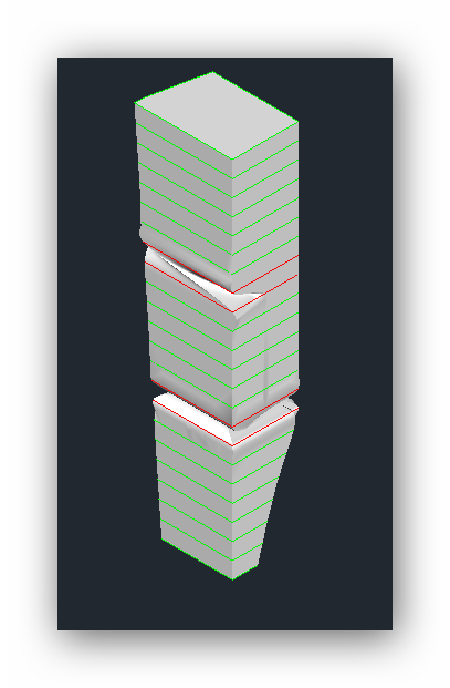

Direct Link To This Post Posted: 06.Sep.2014 at 21:02
If I avoid critical part of the solid it looks fine. Smile
Now must find the way how to close the gaps.

Direct Link To This Post Posted: 06.Sep.2014 at 22:19
If I use each third profile solid looks much better. Also the geometry is not accurate as it can be.

Direct Link To This Post Posted: 07.Sep.2014 at 21:43

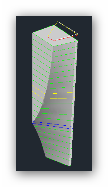

I refined the geometry and the 3D solid looks better.
I still have two places on the solid which should be put in order.
Is the lofting bad approach for such body? I see that only one surface is not good: all surfaces located in one plane are OK. The flow of lines on curved surface seems to be "drunk".
Here is the copy of the drawing:
uploads/497931/VL_za_krmenu_protustatvu_-_2_-_Copy.dwg
I thank for each answer.
