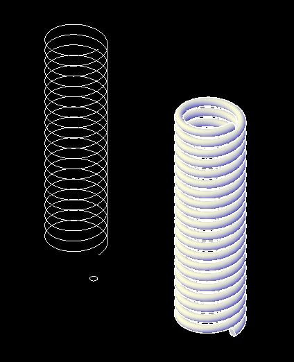

There isn't much work involved in creating a spring using the helix command.  First create the helix, next draw a circle, then invoke the SWEEP command.  Pick the circle as the object to sweep and the helix as the path to follow.  Done.
What visual style are you using?
Did you see any error messages on the command line such as this:
Modeling Operation Error:
     The sweep results in a self-intersecting body.
Unable to sweep 1 selected objects.
If so then the diameter of your circle was too large or the spacing of the turns on your helix were too close together thus causing the swept circle to intersect itself which then results in the modeling operation error.

An example of a 3D spring created using the HELIX command.
Diameter=2
Height=8
Turns=20
Circle radius=.125
