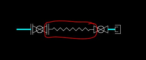

I need a linetype for flexible hose that I can use on a Flow Diagram. I don't know how to create one, so if you have one you can share, it would be appreciate it.

I would recommend you create a symbol rather than a linetype.

One of a handful of flexible connection symbols we use.  This one happens to be flanged on one end and threaded on the other.

That [the flexible-hose aspect, apart from the fittings] appears to be just AutoCAD's ZIGZAG linetype.  Might I assume that mmaurigi is looking for something different?

That zigzag was drawn from scratch.  I know; I drew it a long, long time ago in a land far, far away and before AutoCAD even had a zigzag linetype.
I think the zigzag linetype would be just what the OP is looking for.  He might have to adjust the linetype scale which is easy to do.

Something sort-of like the "look" of the flexible-hose indication in the second link in my first reply, though a little wider in comparison with the S-curvature spacing:
*FlexHose,Flexible Hose graphic, continuous S-configuration
A,0,-.333333,["U",Standard,x=-.333333,y=-.6,s=1.0],-.666666,["U",Standard,x=.333333,y=.6,s=1.0,r=180],-.333333
That's assuming the "STANDARD" Text Style has the default TXT.shx font assigned.  It gets that "U" text element idea from the N12 linetype in my first link [which makes a "drawing" representation of a physical hose, rather than the second link's and this linetype's graphic symbol approach], placing one U on each side alternating [and scaling them differently].
If you don't mind the result being wider, you can eliminate the little crossings of the U's verticals on curves by replacing the .6's in the y coordinates of the text-element positionings with 1.0.
Of course, something with a look more exactly like whatever you want can be done with a Shape definition and a linetype definition incorporating it, or possibly a text element taken from some symbol font such as Wingdings, if you find such a font with a character of the right shape.

Or, here's a version that uses lower-case c's, turned at 90-degree rotations, for a narrower overall width without the crossings on curves that the upper-case U's give you:
*FlexHose,Flexible Hose continuous S-configuration
A,0,-.333333,["c",Standard,x=-.333333,y=.666666,s=1.0,r=270],-.666666,["c",Standard,x=.333333,y=-.666666,s=1.0,r=90],-.333333
