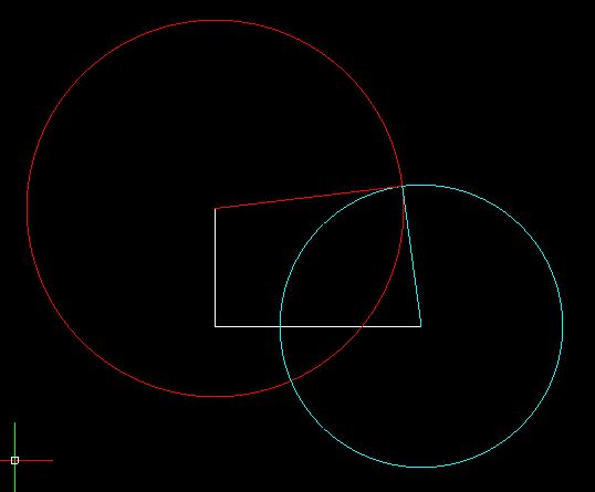

Really?
The red circle has a radius of 6.4 and the cyan circle has a radius of 4.8.  You said you did not care about the angle of the lines so there you go.  The red and cyan lines are the lengths you specified.

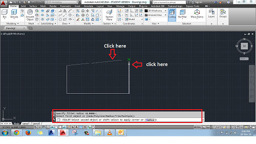

Direct Link To This Post Posted: 16.Nov.2014 at 13:40
I hope this image makes things clear

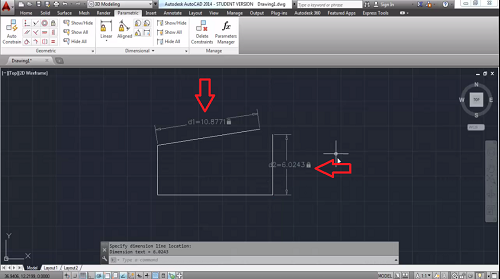

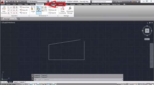

Constrain length of both the lines using parametric tool of AutoCAD and then connect line ends using grip editing.
Admin thesourcecad.com
