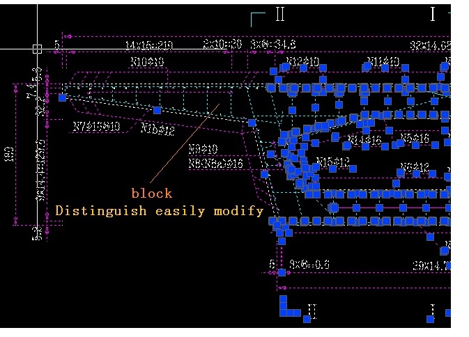

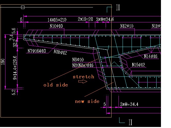

(defun c:tt( / pt1 pt2 mp an1 mode dypnt mp dist pnt1 pnt2 pnt3 pnt4)
  (vl-load-com)
  ( vl-cmdf "stretch" "C" )
        ( while ( > ( getvar 'CmdActive ) 0 ) ( command pause )
  (setq bent (ssget "P"))
  ;The insertion point coordinate origin
   (setq bpoint '(0 0 0) )
  ;Here, as long as the hours minutes and seconds better improvement
  (setq bname (substr (rtos (getvar 'cdate) 2 8) 10 8))
  (command "-block" bname bpoint bent "" )
  (command "-insert" bname bpoint "" "" "" )

Thank you for your attention to my post, my idea is to become piece later with the original reinforced distinguish. Easy to modify. If mixed together will be very difficult to identify the various reinforced.
