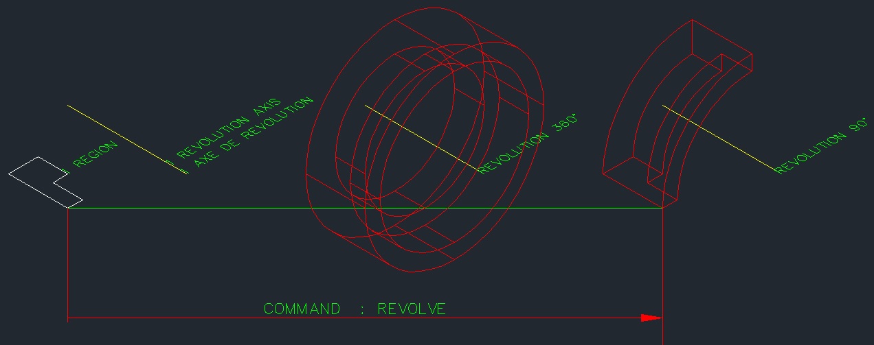

Hello otusbakkamoena, your 3D doesn't look so complicated for it not to be only a or various regions to be relvoved i.e. :
You create in the Z direction a profile that you will REVOLVE around the vertical centerline.
Eventually see my file : 3D SOLIDS 01.dwg here in the CAD / BIM Blocks.
Please tell us if this helped or not.

1. Create a closed polyline profile.
2. Reorient it and draw a single line (red) where shown below.
3. Use the REVOLVE command and its OBJECT feature.
4. Revolve around the red line 360 degrees.
5. Done.
Remember: If you revolve lines you'll end up with surfaces.
