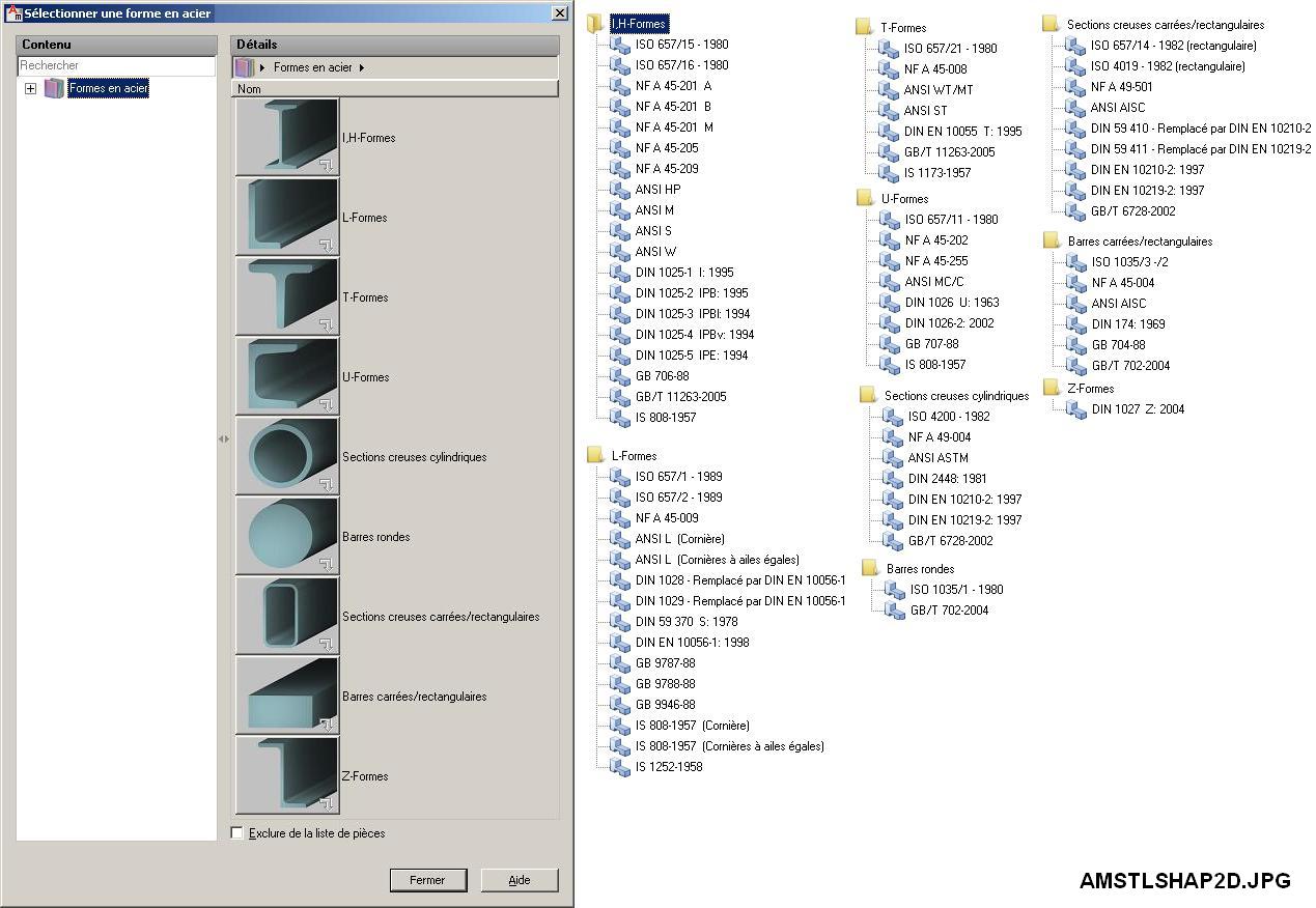

We have recently moved to Windows 7 and my AutoCAD Mechanical was reloaded.
Although the same ( AutoCAD Mechanical 2012 ) I don't find the same profile library with the command AMSTLSHAP2D.
The "old but the same" release gave me also the English ( GB ) old profiles like : GB 706-88 , GB/T 11263-2005 , GB 9787-88 , GB 9788-88 , GB 9946-88 , ( also with Indian ( IS )) etc.
OK now I have the russian ( GOST ...... ) ones.
Anyone around the planet had the same crazy idea of inserting each one of the profiles available in each norm + size like I did with the AutoCAD file here enclosed ?, or an other idea because when you search old profile you will allways want at least all the dimensions to redraw it like length , radius, angles etc... and always a dimension or radius or angle you won't get.
My actual problem is that I have inserteretd blocks that are OK if the norm is in AutoCAD ( dynamic blocks ) but the one that don't have anymorer the norm inside AutoCAD are no more dynamic and are frozne in the olnly one dimension that I have inserted.
