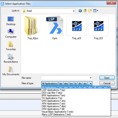

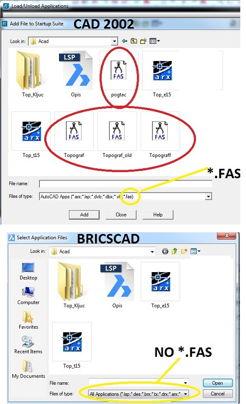

I used a special program for surveying in AutoCAD 2002 and worked without problems. Now I buy the same BRICSCAD but the program will not work in it, throws an error "Unable to recognize command" TACIN ". Please try again." I think that is a mistake in the fact that I could not learn FAS files with the extension.
How do I solve this problem.

Did you click on the down pointing arrow and see if any other file formats were listed before pressing the PANIC button?

I am, and there is nowhere format with the extension FAS

No .vlx either.  Guess you better head on over to the Bricscad forums and see if anyone there has a solution to your problem.  That's where I would have started.
I am very surprised to didn't check this all out before switching to Bricscad.

Bricscad does not support .fas or .vlx. Some reading, if interested, here:
https://www.bricsys.com/common/support/forumthread.jsp?id=14153
https://www.bricsys.com/common/support/forumthread.jsp?id=8248
http://rakeshrao.typepad.com/work_smarter_geotools/2011/11/creating-compiled-lisp-applications-in-bricscad-.html
