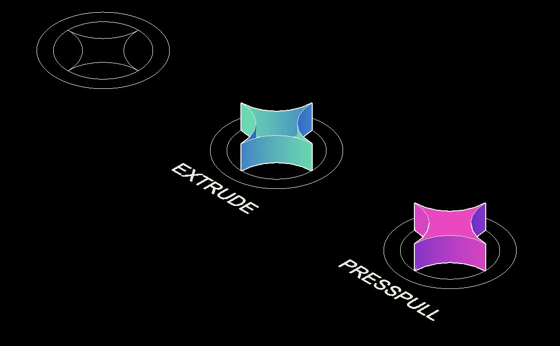

Direct Link To This Post Posted: 11.Mar.2015 at 10:52
An example.  2D star within circle using plain lines/arcs.  Cyan colored star was created using the EXTRUDE command.  Magenta colored star was created using the PRESSPULL command.  If you use the PEDIT command with the JOIN option to join all the arcs then EXTRUDE would result in a solid not surfaces.
