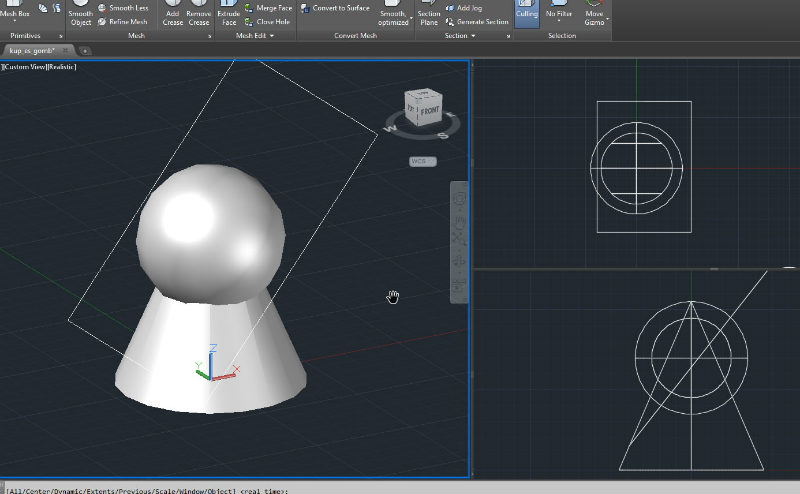

The problem I have now, is that I would like cut through a body. I do not need the section plane, actually I would like to cut the body and delete the upper part. Is it possible?
What I did so far is that I created a cone and a sphere and I united them. (please see picture below). Next I created a rectangle and moved and rotated at the position where the cut should be made.
Could you please guide me and/or give me hints how could I cut that body (sphere+cone)?

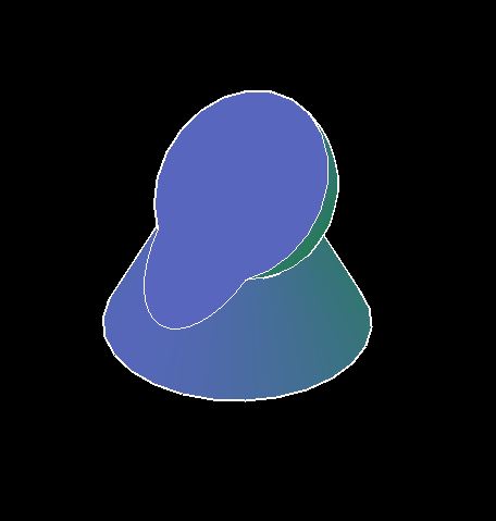

Direct Link To This Post Posted: 24.Mar.2015 at 16:18
A quick example to demonstrate the results of the technique.  You could also use the SLICE with Object option using just the line.
Edited by John Connor - 24.Mar.2015 at 16:51
<<AutoCAD 2015>>

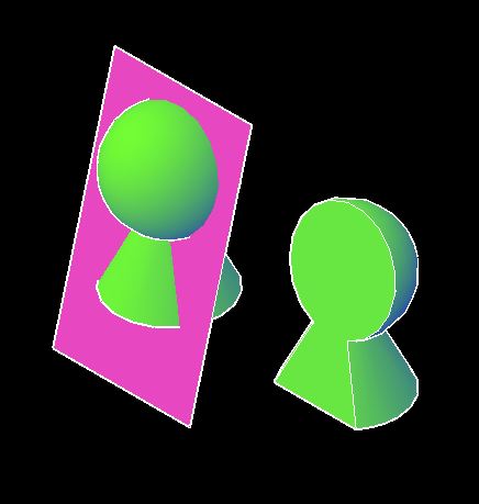

Direct Link To This Post Posted: 24.Mar.2015 at 16:58
Maybe a little closer to what you are expecting?
<<AutoCAD 2015>>

Direct Link To This Post Posted: 24.Mar.2015 at 20:15
Thank you a lot for your reply. However I just cant find out how to slice it.
I allways get fail. I have the options planar object, surface, zaxis, view, zx, zy, yx.
I draw a line extrude it and selected it as planar object but it says: unable to extract the plane of the selected object.

Direct Link To This Post Posted: 25.Mar.2015 at 11:17
Thanks again for your feedback. I do not understand what am I doing wrong. It cuts the cone but not sphere. However they are united and when I click on the sphere or cone it selects the whole body. :(

Direct Link To This Post Posted: 25.Mar.2015 at 16:25
Sounds like your cutting plane is not oriented correctly resulting in a partial cut.  That's why when you pick on either the cone or the sphere the entire 3D model is highlighted.  Look at the first image I posted.  See how the magenta colored surface cuts through and beyond the cone and the sphere?  Does your cutting surface do the same?  Notice too that the cutting surface is also wider than the widest part of the cone/sphere.  This usally guarantees a successful slice.
