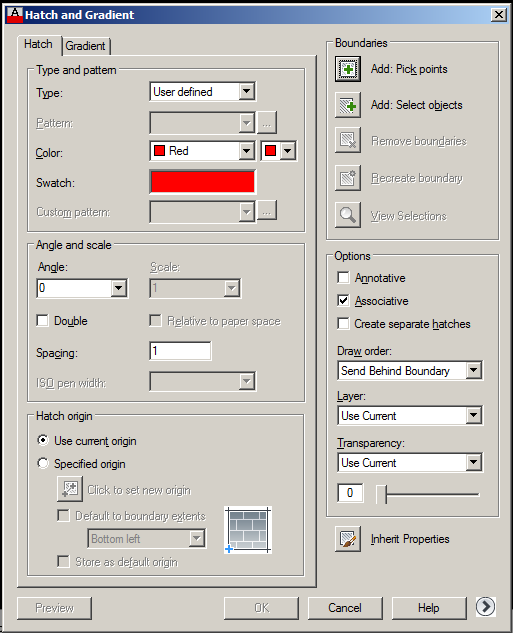

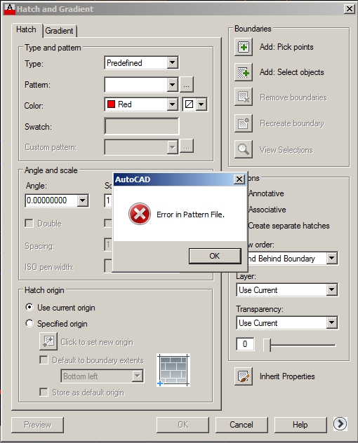

Hi guys,
All the hatch patterns are missing from the hatch library. How can I recover them?
Below are snap shots of the Hatch and Gradient pop-up window after running the command "Hatch".
Hope this is enough information.
Thanks in advance.

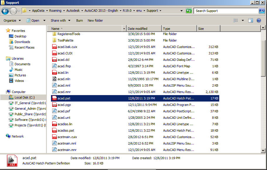

Hi thanks for your quick response.
I have checked the default file location and still find that the "acad.pat" is still present. I am confused as to why the autocad program acted this way.

Ejas:
Given that the message is "Error in hatch pattern" it leads me to believe that someone tried editing the acad.pat file.  Was that you?  Note that AutoCAD did not say "Unknown command" or "File not found."
Tell us, if you type the following at the command line what does AutoCAD return as a response?
Type it exactly as follows.  Exactly.
(findfile"acad.pat")  Then press the Enter key.

Hi,
John I ran the command you advised and this was the result:
Command: (findfile"acad.pat")
"C:\\Users\\conrad\\appdata\\roaming\\autodesk\\autocad 2013 - english\\r19.0\\enu\\support\\acad.pat"
the same location previously mentioned. I did not change anything regards to the hatch patterns as I have changed workstations from before. Perhaps the person using the computer prior to me may have made changes.
