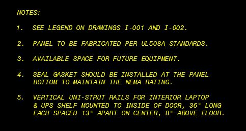

Hello,
I have a file created in AutoCAD2004 where I can see all my MTEXTs. For some reason when the file is open in AutoCAD2015 or DWGTrueView2016, I can not see all of them. Is there something I need to do in order to see them in a newer version? I have attached a file with one of the MTEXTs I'm having problems with. If you open the file in 2004 you will see two MTEXTs and if you open the same file in 2015 you will see only one MTEXT. uploads/550201/File_test.dwg Thank you for your help! |

I found your other text using AutoCAD 2015.
It is NOT a good practice to put objects on the DefPoints layer. That is a hold over from a long time ago that should be abandoned given the fact that objects one does not want printed can now be placed on a separate layer and the "no print" option selected (you know - a red diagonal line through the little printer icon) in the Layer Properties Manager. Edited by John Connor - 07.Apr.2015 at 18:33 |

Hello John,
Thank you for your prompt response. How were you able to find it? When I open the dwg in AutoCAD2004 the text is part of the layer "I-ANNO-TEXT-2" and is not part of the Defpoints layer. What should I change to the 2004 drawing? Thank again for your help! |

I found the text using QSELECT > Mtext > Annotative > Select All. Two objects found. Explode. Guess what? There's your text. Not it is no longer MText or Annotative but you can fix both those problems right?
Re: Defpoints. You have non-text objects in both model and paper space that are on the Defpoints layers. Why? Edited by John Connor - 08.Apr.2015 at 12:22 |

Thank you for your help. It was very helpful.
