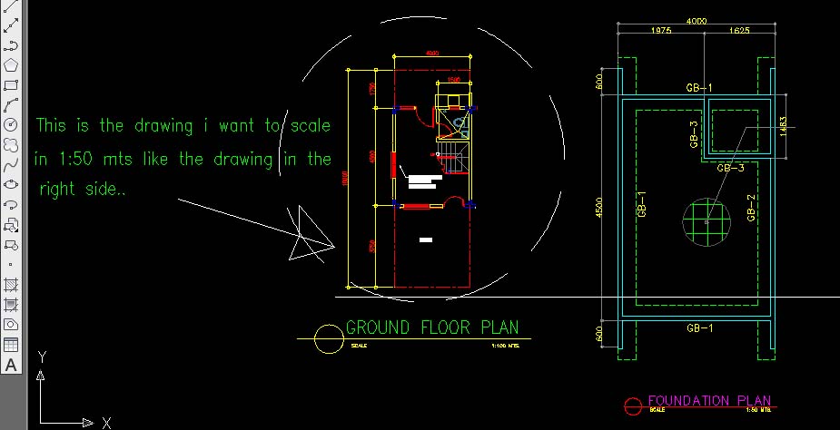

Good day.. I"m having a hard time in get the correct scale.. or to scale the drawing from 1:100 mts to 1:50 mts. Comparing the two drawing, 1:50 is much larger than 1:100 mts. I tried to scale my drawing which is in 1:100 with the reference scale factor "2" and i compare it to the 1:50 dwg but it did match...TIA
I hope you can help me guys.. thanks a lot.

Please confirm you are in a paper space layout using at least one viewport. Yes/No/Not sure?

no i am working in "model" and i have a 20"x30" template or A1 size paper..
In "layout" i paste the template and put one viewport and zoom it with 1/5xp and drawing is still small...

It sounds like you have a mixed units problem. You reference a scale factor of 1:50 (metric) yet your paper size is stated in imperial units (20"x30"). Never a good idea to mix metric and imperial.
Attach a copy of the drawing to your next post or upload it to the CAD Blocks section of this website. Images aren't useful at this point; we need a DWG file. |

Please see attached file.. this is the sample cad file that i am working with.. 1.Another question is.. the elevation in the drawing said that is scaled in 1:50mts. But when i draw a line with the same measurement like 5.000 mts and compare it with the drawing.. it's the same but when i measured its dimension it gives me the wrong dimension.. 2. How can i scale the elevation into 1:20 mts like in section details... or is that i draw it first in 1:100 mts and then just scale/resize it bigger to <scale><reference>2.? Thanks. CAD FILE: uploads/552290/FOR_CAD_FORUM.dwg

Hello akoarkitekto, you have mainly 2 problems on your file :
The drawing on the right has beem scaled by 2.5 and the dimension style STANDARD$0 for linear dimensions has been modified with a scale factor of 0.4 to cope this ( x2.5 = 0.4).
It's better to work at scale 1/1 and open viewports in the paper space to have different paper scales.
The drawing on the left is OK ( drawn in meters , dimension style STANDARD$0 is working ).
You can work with different units in different files or insert ( and not copy/paste ) different units files inside the first one but you have to set UNITS with the good value in the diffrent files. Edited by philippe JOSEPH - 16.Apr.2015 at 14:07 |

Hello Akoarkitekto, I think that you will have to learn about viewports in the layout space ( paper space ).
In AutoCAD or you work in the model space ( and you have to "scale" things to have different scales in the same drawing ) or you work at scale 1/1 in the model space and open viewports in the layout(s) at different zooms ( scale ) to set different scales on the same drawing.
Have you open the file that I have uploaded : FOR_CAD_FOROMPJH.dwg and took at look at it ?
The concept of view ports is maybe difficult in the beginning but after it offers much security ( no scaled drawings ).
The model space is the workshop and the layout space is the screen of your computer in the office.
You should ask for this to your teachers, friends or colleagues at work.
You should find lessons on the internet about this, maybe in CADTUTORIAL or AUTODESK COMUNNITY or...
Launch a search with : autocad viewports.
Take alook at this : https://www.andrew.cmu.edu/course/48-568/PDFs/AutoCAD2D/Chapter28.pdf
Ask for more and have a good day. Edited by philippe JOSEPH - 17.Apr.2015 at 09:19 |
