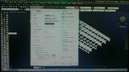

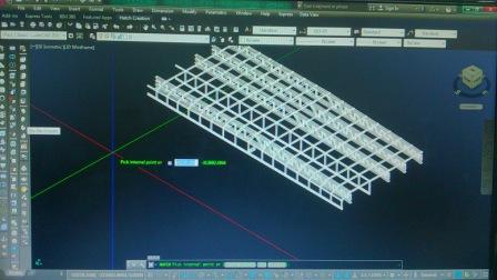

help pls. somethings wrong in my cad software. instead of pic 1, pic 2 is showing. its the same to all command that have sub windows for option. pls help me how to fix this for those who know. by the way i have 2 version of cad installed and it have the same problem. thanks for those who came fix this, i enter the same command here. and pic 2 need sub command to show pic 1

Are you referring to the fact that you do not see dialog windows?
Try setting the system variable FILEDIA to a value of 1.

thank you so much john connor,
you are a legend Clap
