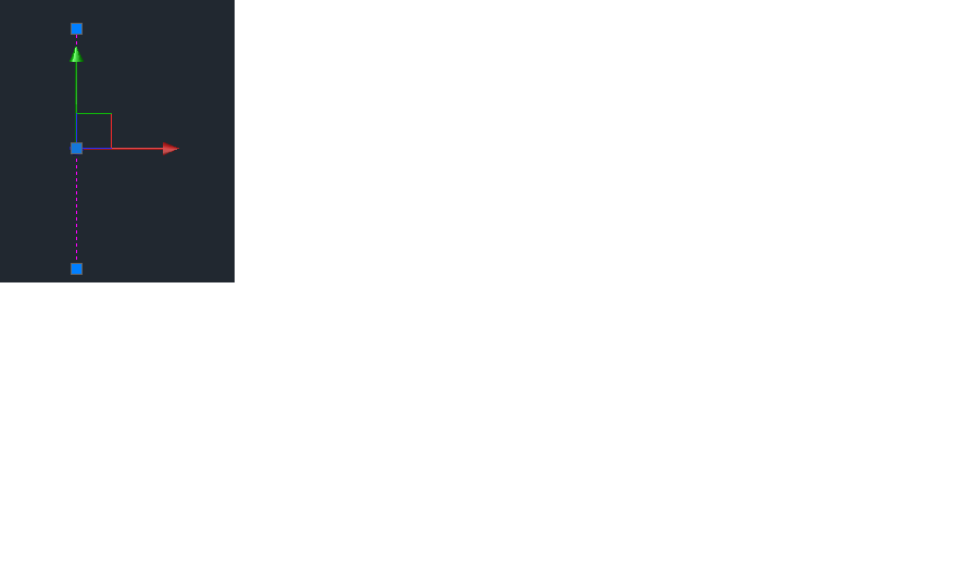

Hello,
I have a problem which has recently showed up in my drawings and I have not found any solution how to swich that off. When I click on any line / point / object, a collored CS is showing at that point. This makes my cad very very slow I am basically unable to draw normally. I am attaching a picture where that is visible. I would be very grateful in case some of you could help me to solve that problem I am getting desperate..... Many thanks in advance!

Hello MartinaCAD, your computer is slow because you have changed the visual style to realistic or conceptual.
If you aren't working in 3D it's not necessary and if you are working in 3D I recommand to set it to take a look at the result and not when working because it might lead to non desired grips on non visible entities.
To set back your file to 2D wireframe clic on the good icon if you have it or use the command VISUALSTYLE and take a look at the options on the command line.
If all this is not working take a look in the AutoCAD help ( F1 ).
By the way, take also a look at your dynamic mode ( F12 ) as there won't be any indication of state on the command line but only a change of apearance on the relative icon  down on your screen..
Please tell us if this helped or not and have a good day.

Hi Philippe,
thank you a lot yes, this helped, I should´ve clicked in there by mistake so I didn´t know what to click to put it back to normal.... It works back okay now.
Thanks again and have a good day as well!:)
