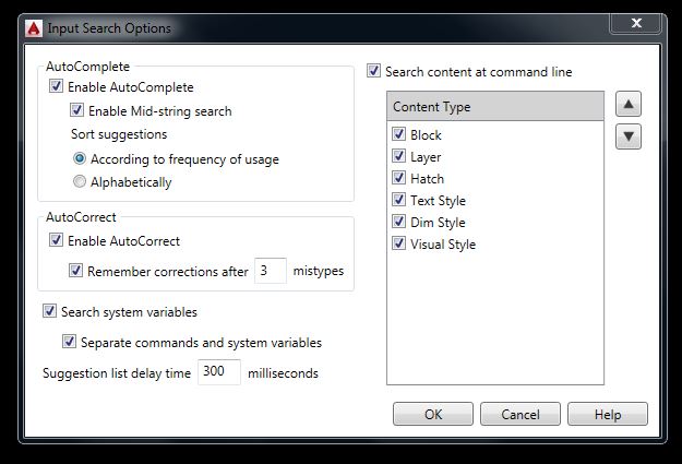

Direct Link To This Post Posted: 09.Jul.2015 at 23:26
Did you just recently install the program?
Type INPUTSEARCHOPTIONS at the command line then press the Enter key.  Look at the dialog box.  Note the options that are available and what your current setting are.  Change the settings to suit your needs.
The first two options you might want to change are AutoCorrect re: number of mistypes and the delay time.
Edited by John Connor - 10.Jul.2015 at 12:19
