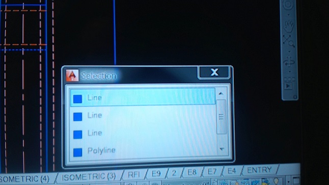

can somebody tell me how to get rid of this annoying pop up dialog box every time i make a selection this piece of (cuss words) pops up and cuts off my command that im currently using just to tell me what the object is that im selecting i just about punched my monitor it so damn annoying, i normally use autocad classic, which i love, this popup is new to me,  help me please

SELECTIONCYCLING variable to 0.
toggle via Ctrl W

The default value for that system variable is -2 meaning selection cycling is turned OFF but the setting is stored.  YOU must have inadvertently enabled the feature by pressing CTRL+W thus causing the annoying behavior.  Don't blame the program; blame the operator.
