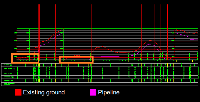

I made a pipeline design by the following steps:
•Draw a line in plant with the pipeline path in the existing grund
•Create an alignment
•Generated the existing grownd profile
•Then, using the alignment creation tools I made a line which matches to the pipeline profile

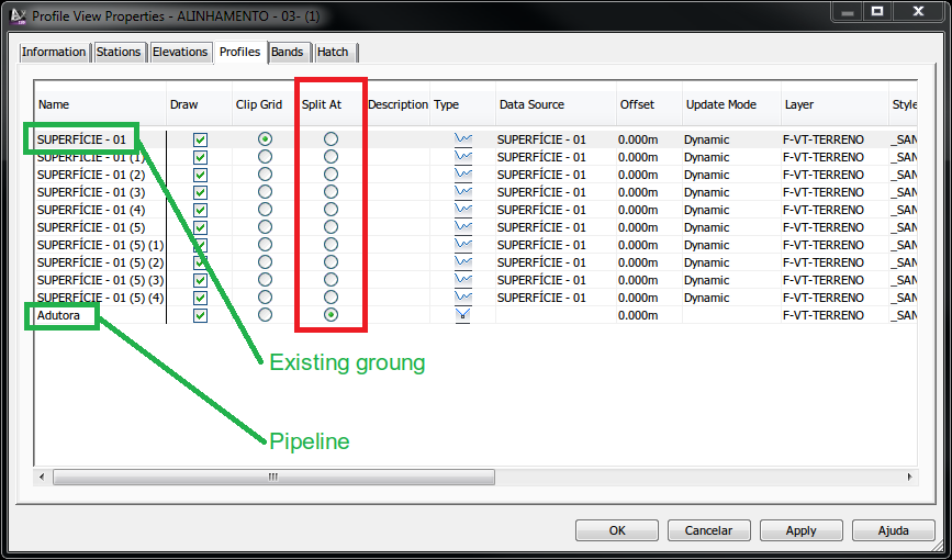

The elevations exceeds my sheet layout part reserved to the profile, then I made a profile split. But when I make this it hides some part of my profile, or my pipeline profile or my existing ground profile, it depends what I select to "split at" in profiles (I can't select over than one option).Angry
I need to make a profile split which whows the pipeline profile and the existing groud profile, how can I do this?Smile
The following picture shows the profile before the splitting:

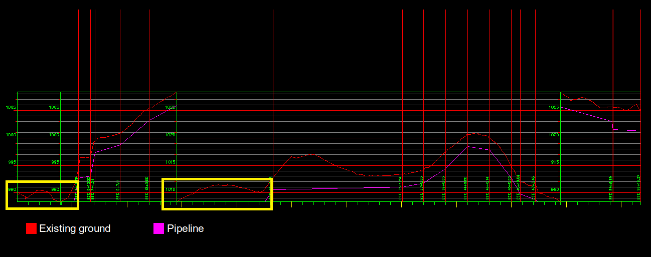

And the following picture shows the profile after the splitting:

What are you using for horizontal and vertical scales?

I am using:
Vertical scale 1:200
Current horizontal scale: 2000
Vertial exaggeration: 10.000
Custom scale: 200.000

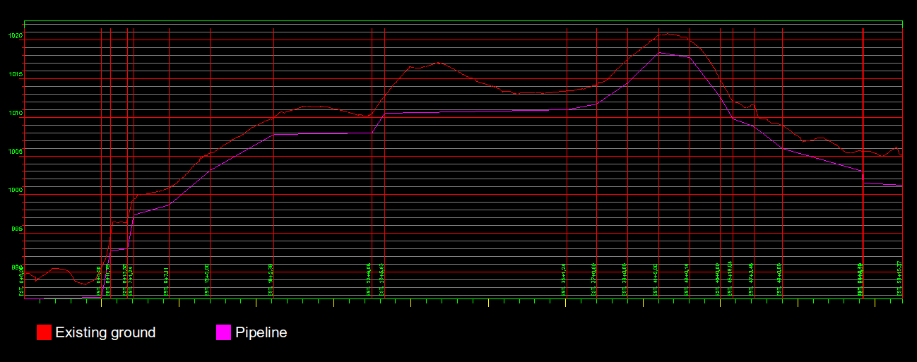

Look at these two cases:
First one I select to slplit at pipeline, in this case it hides a part of existing ground
Second one I selected to slplit at the existing groung, in this case it hides a part of the pipeline
I can't hide parts of existing grounf nor pipeline, "split at" don't gives me the option to select them two, I thought about define a minimum height manually, but I even don't know the way to do this

This profile will be divided in two sheets, in each range the elevation can't exceed 35 meters, this one exceeds, then we need to split in 33 meters to show a lower range, but I get into a trouble, even I split, I can't hide anything.
