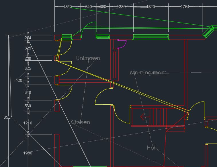

Hi all,
Can anyone let me know why these ghost lines have appeared once i started adding dimensions and labels to my drawing. I am a novice user. See below pic...Many thanks! |

turn off the LINESMOOTHING system variable or disable hardware acceleration using the GRAPHICSCONFIG command via the Graphics Performance Dialog Box, may this can help you.

Thanks jmontesmx...
Problem solved, thanks for the advice...
