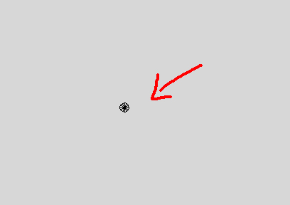

Hello! There's this weird circle at my drawings that I don't know what's the purpose of... Does anyone know how to get rid of it?

You may switch off that beautiful marker with the GEOMARKERVISIBILITY variable, sir.

Thank you, Mr. Novarese Smile
