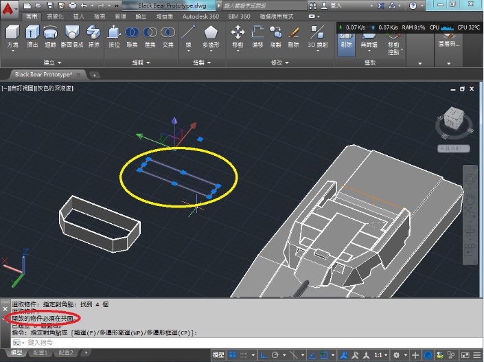

i
 have some problem....
1. i can't use the "Box"
when i set the length and width it will disappear
or whet i type "box" and click the the second dot it will disappear too....
2. sometime can't region
it will said "Open objects must be coplanar"
i have no idea ....
there is video
Edited by Proladon - 29.Aug.2015 at 05:38

Re: coplanar.  Means the lines must have the same elevation.
Re: disappearing box.  Are you drawing it on a layer that has been turned off?

coplanar . i confirm lines r on the same elevation (in video u can see
disappearing box . nope,all my layer is turn on

Well without a copy of the drawing it would be difficult to figure out what exactly is going on.  Upload a copy or make it available via Dropbox.  Someone here will take a look at it.
Maybe some of the lines were drawn using a different UCS.
