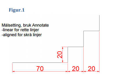

Hello. Im just starting to use AutoCad and need some help to understand it. If someone could do this easy figures for me in a Autocad and at he same time tell me step by step what you're doing I would be SUPER happy! These figures should be very quickly done if someone knows autocad. Thank you very much <3

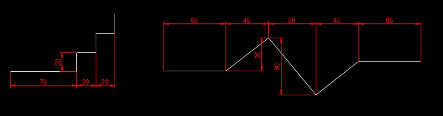

It should take you less than five minutes to draw the lines AND dimension them as well for the first two figures.  I know because I just did it.
For figure one make sure Orthomode is enabled then start the line command.  Pick your start point then drag your cursor to the right.  STOP.  Go to your command line.  Type in the number 70.  Now drag your cursor upwards.  STOP.  Go to the command line and type in the number 20.  Keep repeating until you have drawn all the lines.  This is called direct entry input.

Yes, I really did draw both figures.

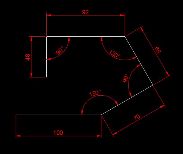

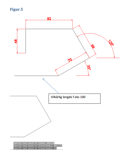

You should have had figure one drawn by now Sarah.  It is the easiest one of the bunch to do.  If you are struggling with figure one then you are going to have even more problems with some of the other figures like figure five for example.
Everything here should have been covered in class.
Figure five with a little extra information thrown in.
Here's how to draw figure five using the polyline command or PLINE as it is called.  This is all done from the command line after starting the command and picking your first point.
Command: _pline
Specify start point: pick your first point then type in exactly what you see below.  Press the Enter key after each input.
Current line-width is 0.0000
Specify next point or [Arc/Halfwidth/Length/Undo/Width]: @48<90
Specify next point or [Arc/Close/Halfwidth/Length/Undo/Width]: @92<0
Specify next point or [Arc/Close/Halfwidth/Length/Undo/Width]: @66<300
Specify next point or [Arc/Close/Halfwidth/Length/Undo/Width]: @70<210
Specify next point or [Arc/Close/Halfwidth/Length/Undo/Width]: @100<180
I enable orthomode, f8, right? Use line function "l", start drawing to right, stops, and write number 70 (in the "l" function or just the "type a command" setting?) should the "dimensions" come by itself after typing 70? Cant get the dimensions up.... Nothing happens when I write "70"

You type the dimension of 70 after the AutoCAD prompt.  This is what you should see on screen:
Command: L
LINE
Specify first point: you pick your first point onscreen
Specify next point or [Undo]: 70
Now do you understand?

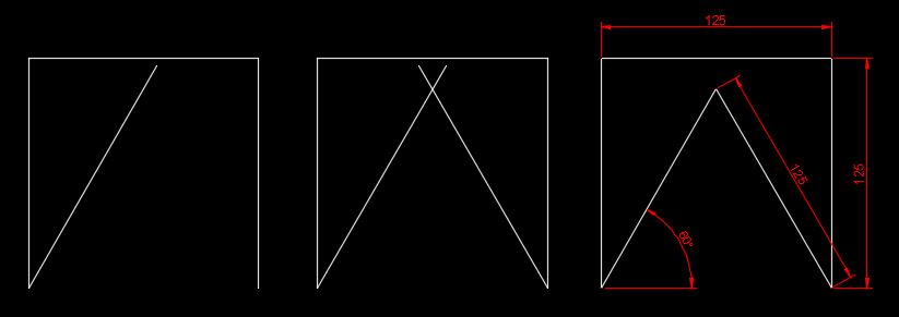

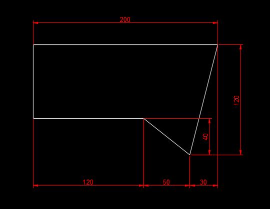

We'll make this one easier with a three step process.  You'll need to use either the Trim or Fillet command to clean up the intersection of the two crossed lines.
