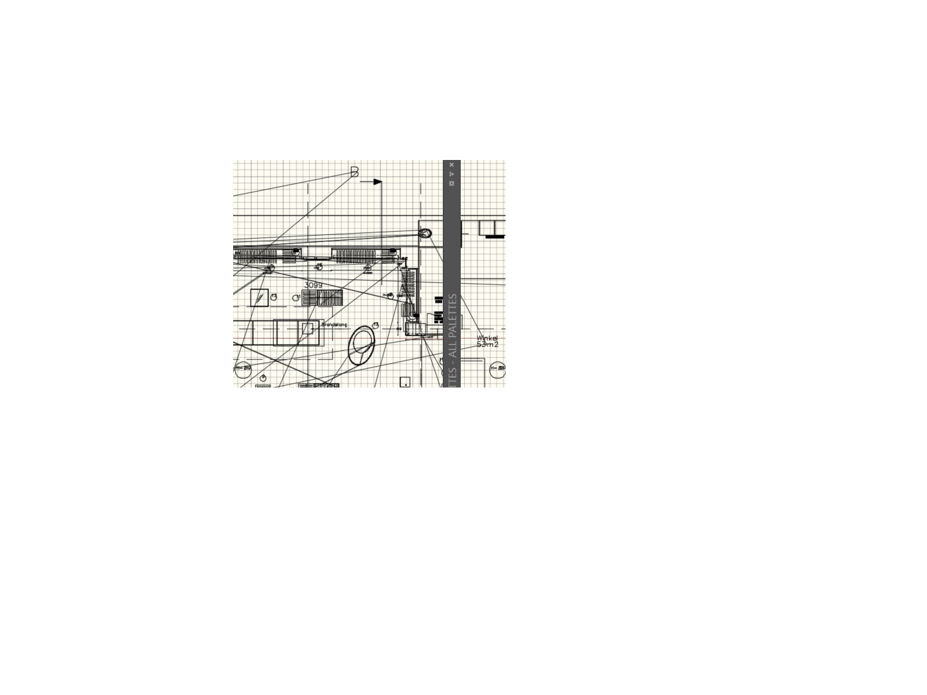

Since I use windows 10 all my drawings have criss-cross lines wich can not be selected or deleted. Anyone an idea how I can get rid off them? See image:

Just found the solution myself: rightclick: Graphic performance (bottom right) than de-select "smooth line display". problem solved!
