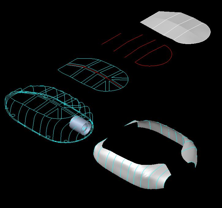

I designed a quad copter case and am hoping to 3d print it.  To that end I have a wireframe of the shape I want and I am trying to stretch a surface between multiple plines which are not closed and each are on different planes.  None of the commands seem to do what I need.  Anyone have any ideas?

Have you tried the LOFT command?

Example of surfaces created via the LOFT command using some of your geometry.
