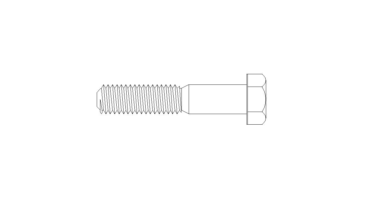

An example of a 2D threaded bolt I created.

Dear Fahim and John, eventually see these files :
You will notice that I have used a little AutoCAD block that you can copy + scale on each diameter.
Ask for more.
