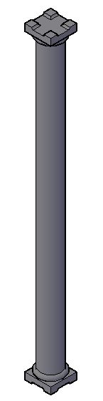

Direct Link To This Post Posted: 13.Jan.2016 at 12:41
A simple 3D pillar created using solids.
