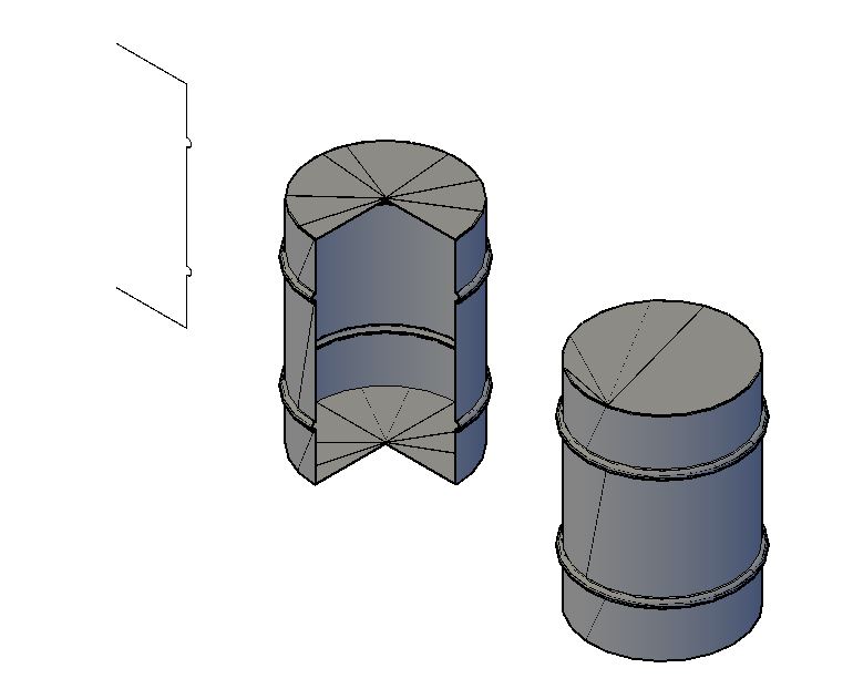

Chemical drum in profile, revolved 270 degrees, and revolved 360 degrees.
Visual style: Conceptual
Both drums are solids.
