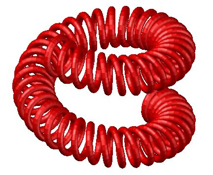

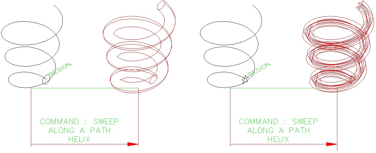

Direct Link To This Post Posted: 03.Mar.2016 at 07:20
Hello svizoman and John, eventually see this image and my file : 3D solids 01.dwg in the CAD/BIM library right here in the site :

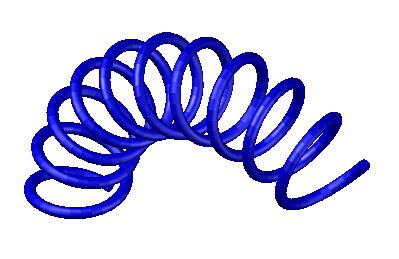

The word spring automatically brings to mind a helix but is that a "curved" spring?  Reread the OP's post as he even mentions the word helix then look at the next sentence.  He also mentions "curved pipe".  I imagine he is looking for a 90 degree curved spring or something similar.
Something more like this.

Direct Link To This Post Posted: 03.Mar.2016 at 12:43
Created this using a custom lisp routine.

Direct Link To This Post Posted: 04.Mar.2016 at 10:32
Hello John, I'm trying to do my own one with the help of EXTRUDE along a 3D Polyline and its with facets.
The 3D polyline is really difficult to draw as I can't see nothing in a jungle of points in the screen !

Direct Link To This Post Posted: 04.Mar.2016 at 11:41
That's why I went looking for help from a custom lisp routine.
