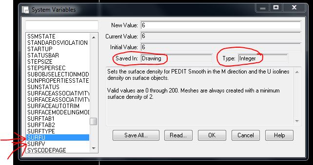

The default of ISOLINES ON SURFACES are 6 in U and 6 in V.
This setting is in the #D MODELING tab in OPTIONS.
If I change these values to 0, it just change it for the current drawing
My question is, how do I change this values to 0 PERMANENTLY or as the DEFAULT.

The values are assigned as an integer that is saved with the drawing it is not saved in the Registry which means it is NOT global.  I suppose you could set it using lisp and put it in your acaddoc.lsp file or in your StartUp Suite.

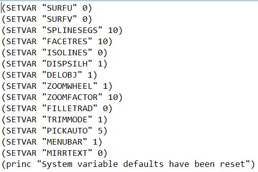

Thanks a lot,
As you can see, I did a whole lot of others too. They were bugging me for years. Work like a charm.
Any suggestions of others I can include. What are your favourites?
Cheers.

Direct Link To This Post Posted: 23.Mar.2016 at 22:27
PICKADD and FILEDIA.
