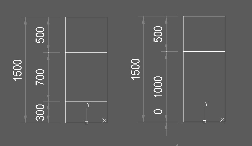

Hi All,
I couldn't find answer to this matter. Please see if you can help.

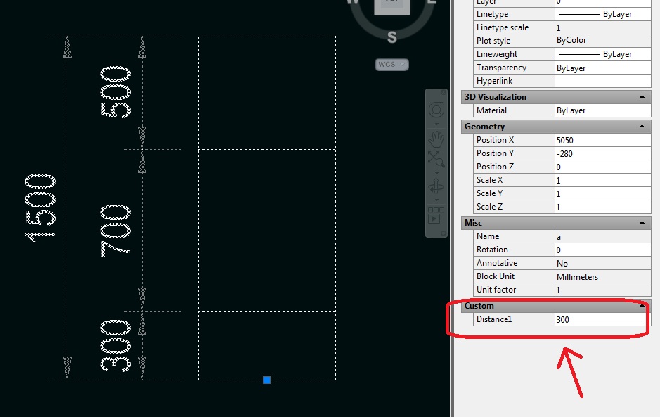

As you can see in the picture, the shape on the right side shows a dimension with a value of zero. This is a dynamic block and you can change the height of first line along with it's dimensions from properties menu.
Question:
Is there anyway to set the dynamic block so if the value of a dimension is 0 then the whole dimension goes hidden automatically without the need of editing the block?
If not all elements of the dimension, can the text goes hidden or replaced by a space character which shows nothing? Tags are not an issue, if we change them to architectural tags you wont see extra line.

I doubt this can be done with just the dynblock functionality but you can use the following LISP code to hide "singleton" dimensions automatically:

I opened drawing that I attached, select the block, and set the "Distance1=0" in the properties.
Bottom Dimension changes to a zero. Then I try your command, it does not hide the dimension.
I draw another dimension, select it, put one grip on another, dimension becomes 0, and then I run your command, it works and dimension disappears. I draw another zero value dimension. make a block out of it. run the command. It doesn't work. I explode the recently made block of the dim and run the command again. It works.
Problems,
1) The lisp cannot hide zero value dimensions within blocks and you have to explode blocks.
2) The lisp cannot find all zero value dimensions.
3) The hidden dimensions exist in the drawing (you can check by select all) but you cannot recover them and make them appear.
I am not asking you to go through your lisp and fix the problems i mentioned. I am just letting you know these for your information.
I am after a solution so that when you put a grip of a dimension on another grip of the same dim it disappears because the value became zero and/or if you change a dynoblock and some dimensions withing the block change to zero they disappear. If they are withing a block they are easily recoverable by changing them by block grips or in properties menu.
