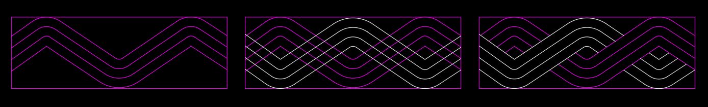

Any tips on how to do this swirlytile mosaic in a 4" x12" in Autocad LT. dkominik@gmail.com

uploads/421007/tilemosaic.zip
I thought I had include this...this is what I am trying to do as a tile border in a bathroom. Any tips?

Use IMAGEATTACH to bring the image into LT then trace over it. Resize as required. When you are satisfied create a block.

I guess I'm not good at doing curves. Would I use ARC? How does ARC work? Or should I use a different tool? I did the IMAGEMATCH.

Yes, you could use the Circle or the Arc command. Or...you could trace over the linework using a single continuous polyline then invoke the PEDIT command and either Fit curve or Spline.

This took less than three minutes to do using the ImageAttach, Polyline, Fillet, Offset, Trim, Mirror and Rectangle commands. Initial size: .45x1.36. Now all one would have to do is scale it up to whatever size is required.
