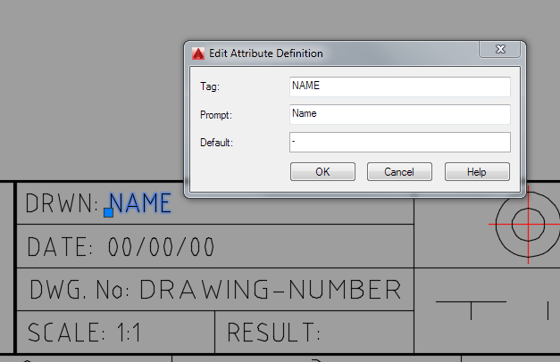

Hi, I have a title block in my paper space that I need to put name, date etc on but editing the attribute definitions doesn't show any changes. Not sure what I'm doing wrong. Searched for but couldn't find the answer. Thanks in advance.

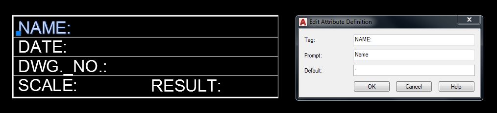

OK...my guess is you created an attribute and clicked on it thus the reason why you are seeing the Edit Attribute Definition dialog box.  What you failed to do is then create a Block and making this, and any other pertinent attributes, part of that block.  Am I correct?
I was able to reproduce exactly what you showed us in your first post re: dialog box (to right).  Although there are five attributes they are not part of a block.

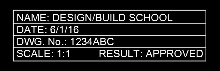

OK...now here are the same attributes but they have been assembled together in a single block called "TitleBlock".
