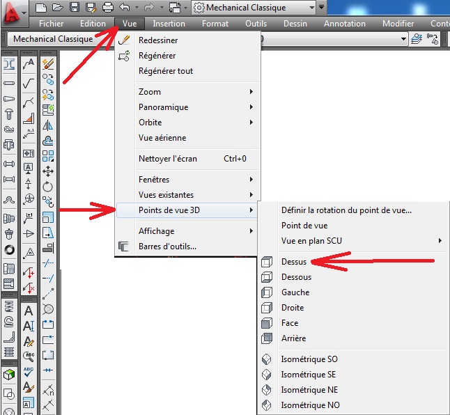

Hello darbi ( and John ), maybe you are only in a 3D point of view and you want to work only in 2D.
If yes, check if the UCS is on World and type the command PLAN option Current to go back to your 2D point of view.
You can also have the 2D and 3D points of view in the menus.

Direct Link To This Post Posted: 21.Jun.2016 at 12:44
Hello again darbi, sorry my AutoCAD is Mechanical classical in french.
See if you can do this :
