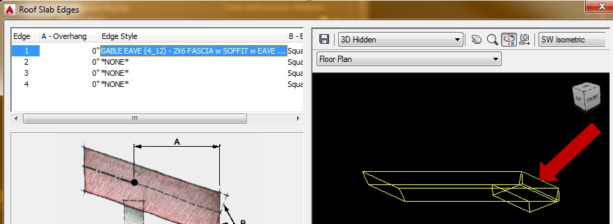

Does anyone know of a way to change the default color of the edges of a roof slab when assigning slab edge styles? The default color is a pale green, is this able to be changed? This is only when being shown in the preview window. I've attached an image showing the preview window.
Thank you in advance!

If anyone is following this post, I've come up with solution. Creating a new Display configuration seems to be the easiest solution for this. The preview is actually generated by the display configuration. When viewing the roof slab edges in the preview dialog box you can switch the display configurations.
The display configuration shown below was created just for this purpose.
Hope this helps anyone who has encountered the same issue.
