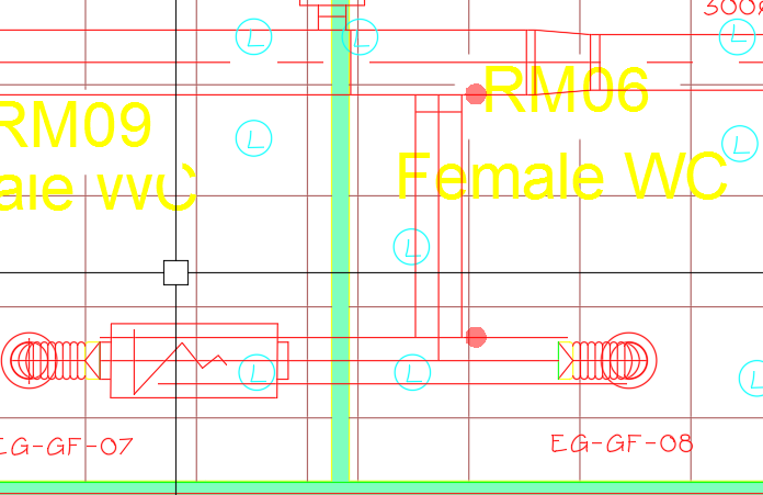

    Posted: 01.Jul.2016 at 15:51
At least they seem to be something like- unexplained
LT2017 drawing bylayer colour filled circles appear at the end of lines and wont go away- tried erasing the lines but they remain in model space and can be seen in paper space as well as unscaled larger filled circles
Regenall gets rid of them but then they appear somewhere else at the end of another line?
Erasing the line and trying to pick the circle and it doesnt exist?
Any ideas? Regenall fixes it but what are they?
Ta
Andrew

Can you post an image?
Are the circles red?
Are you doing any hatching using these lines?

There was two that just popped up which I was editing some ductwork adjacent
The circles are bylayer colour

just did a regenall and they disappeared but while they are there they appear as large filled circles on the paper space layout space?

Direct Link To This Post Posted: 01.Jul.2016 at 18:32
I don't recognize them and without a copy of the drawing to analyze I can't offer a solution at this time.
If you start a new drawing and draw a couple of lines do they show up?
Try disabling GEOMARKERVISIBILITY and see if they disappear.  The value would have to be set to "0".
Are you doing any hatching utilizing these lines?

I tried to reproduce the problem on my CAD system but was unable to do so.
Did you get the drawing from an outside source?

Direct Link To This Post Posted: 03.Jul.2016 at 14:51
Some.
I transferred up my 2007 drawing sheets on paper space, pasted externally sourced architects drawings into my model space and then drew up standard ductwork items and then used lines and fillets to join up the dots
These circles  appear after doing some fillet and line commands but as you see on my screen shot these current ones are not even on the end of a line and cant be accessed with the cross hairs- strange
Still I know a regenall gets rid of them so no real problem
Next problem is a new PC as my laptop is struggling with the poor graphics card and RAM which was fine with lt2007- hey ho!

Did you try disabling GEOMARKERVISIBILITY?
