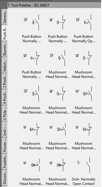

What i mean by Using Wblocks is that you create a library on the job and drag and drop them in a new Toolpallet so you can use them later.
In this way you only have to select de correct size and directly insert them in the drawing.
FoR Example
I think with dynamics blocks it is still to much manual handling.
Most idealy is create a lisp or vba with calculation function so that you only have to give 2 or 3 WxHxD dimensions.
