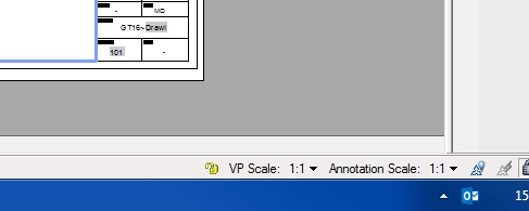

Hi guys, I need some help!
I have a paperspace tab with title blocks as standard. I have a viewport preset to the remaining space. Some objects I can fit in here at 1:1 scale.
However when I plot and print, it's never to 1:1 scale!
I've set everything up as far as I know is correct, but instance my 90mm x 90mm square printed 1:1 at A4 is about 60mm x 60mm. Ideally I want to print to scale, but still show my titlebars with info/company details etc
Help!?

Yeah.  Why did you set the scale to 1'-0"=1'-0"?  That's an imperial scale.  You are working in a metric drawing.  You should have selected 1:1.
Layer "X" should be renamed to something that makes sense.  Your viewport layer should be set to "no print".

From what I can see my scale is set to 1:1. Where did you find this and how can I change it please?

I found it by double clicking in the viewport and then looking at the bottom right hand corner of my screen where it tells you the scale of the viewport.

Strange...this says I'm already on 1:1!

Draw a square in model space on layer RED that is 90 x 90.  Switch to the layout, activate the viewport and do a Zoom > Extents.  Look at the scale that is reported.  Is it something like 3.08....?

Yes, 3.095...
But if I change it to 1:1, why doesn't it work/print as 1:1?
More importantly, what do I need to change or do to have it work correctly? :)
Doesn't zoom extents just show the drawing tight to the viewport, regardless of size or scale?

Did you change the viewport scale to read 1:1 or 1'-0"=1'-0"?
If you did change it to 1:1 it will be easy to verify.  Make sure OSnaps are enabled then dimension the top of the square in your layout not in model space.  It should read "90".  Mine does.
