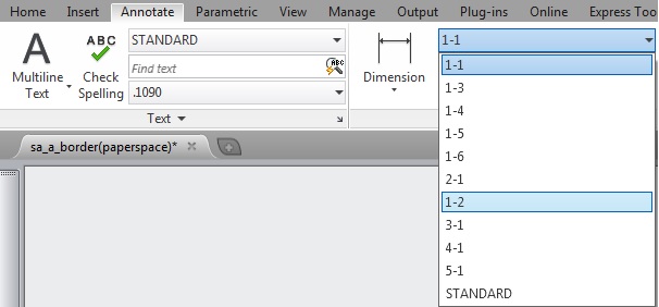

Hey guys,
I know there are ways to edit attributes and the order that you can fill in the blanks. I also know there is a way to do the same with viewport scales. I want my dimensions to do the same thing.
I've attached an image of how my dimensions show up in the drop down menu when I'm selecting one. The 1-2 is listed far down the line with 2-1 but I want it just below the 1-1 dimension style.

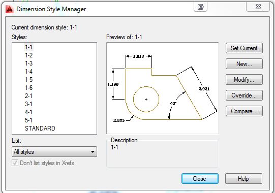

Anyway I can edit this? The dimension style manager doesn't give me the option to choose the order. It is already how I like it in there.

Delete and recreate the dimension style.  It should assume its correct position in the list.
Another option is to Rename to something like 9-9.  Then rename back to 1-2.

Direct Link To This Post Posted: 21.Sep.2016 at 18:37
I had to purge and redesign them anyway. So deleting and remaking worked.
Thanks
