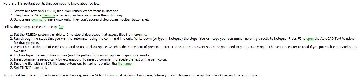

Maybe this will help get you started.  It's quoted from Ellen Finkelstein's website.

Take a look at Lee Mac's Script Writer.
http://www.lee-mac.com/scriptwriter.html
