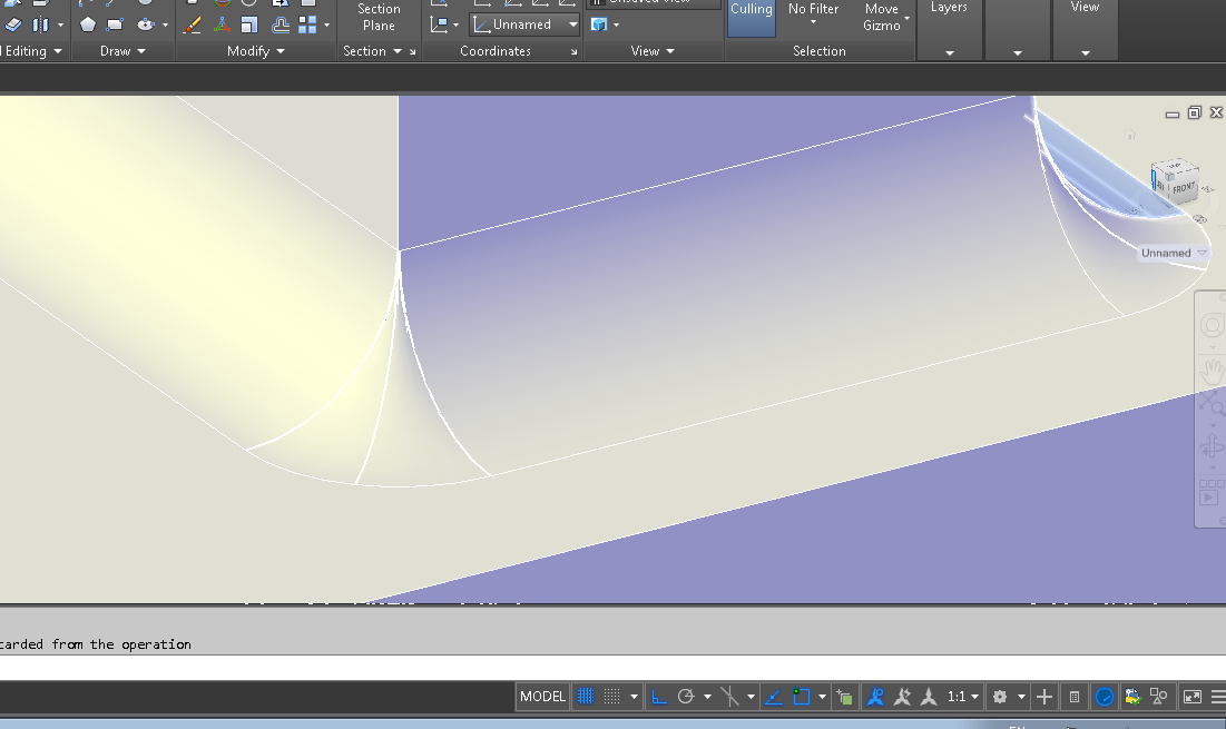

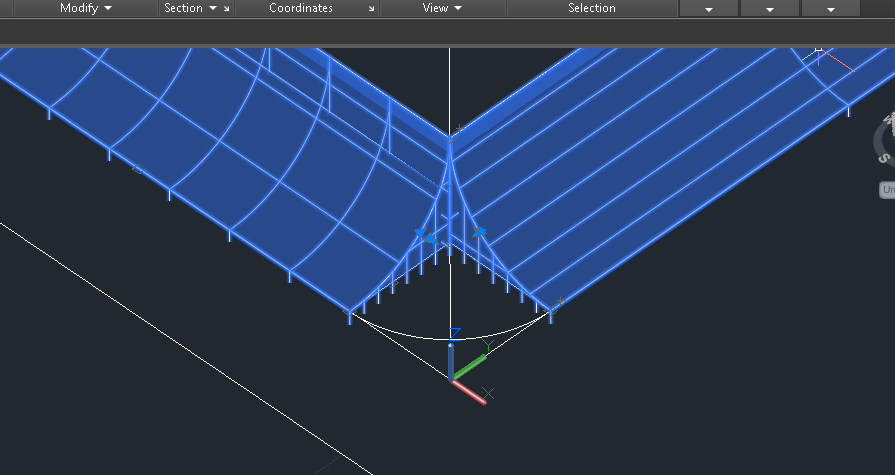

Hello everyone
I'm a student and I am trying to learn AutoCAD from web tutorials as much as I can at home and after I finish High School to follow some drafting courses.
So I need to join the 2 arched blocks together. Is there a command to help me do that?
Sorry if I didn't explain that clear, hope you understand.
Thank you!

One option would be to extrude the cove-like profile along the path of the partial circle.

Or revolve the profile through 90 degrees

I did it using the Revolve command because it appeared easier and I'm only a beginner but I believe that someone more experienced could do it with extrude or other commands too. Took me some minutes until I chose the right base points .
